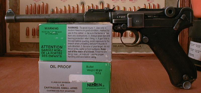

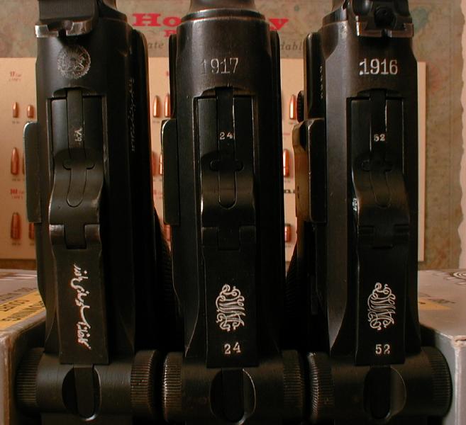

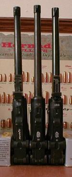

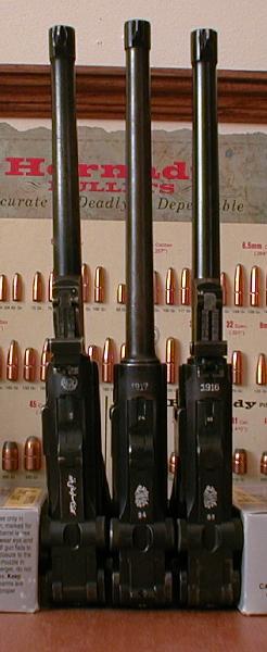

Three Artillery Lugers. From right to left, DWM 1914 Military chamber dated 1916,
1920 Commercial, Persian Artillery. On the 1920 commercial, note the absence of the
800 meter tangent sight. This pistol is also chambered for the 7.65 Parabellum rather
than the 9 m/m Parabellum. |

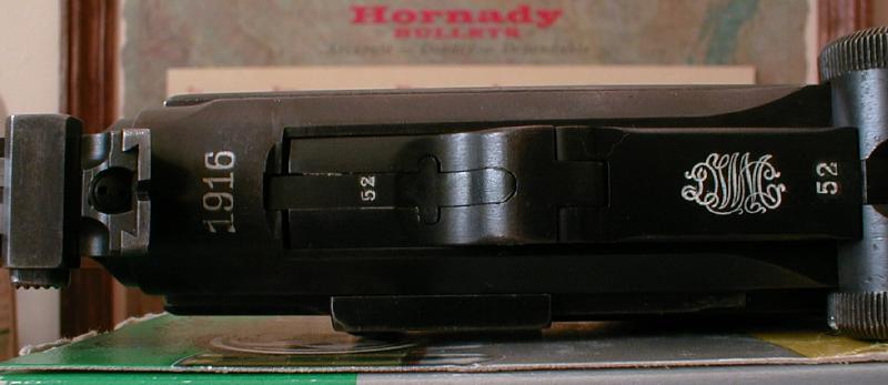

Close up of 1916 dated cannon. Note DWM script, serial numbering of first toggle
link and extractor, ì1916î chamber date. Rear sight is fine tune variation,
and fine tune screw is partially visible in front of rear sight aperture. |

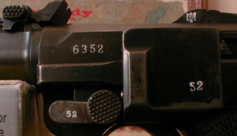

Left side of 1916 dated Arty. Note serial numbering of barrel extension, side plate,
and take down lever. Firing proof just visible on rear of breech block above barrel
extension. |
Close up of left side markings. Note fine tune index on left side of rear sight. |

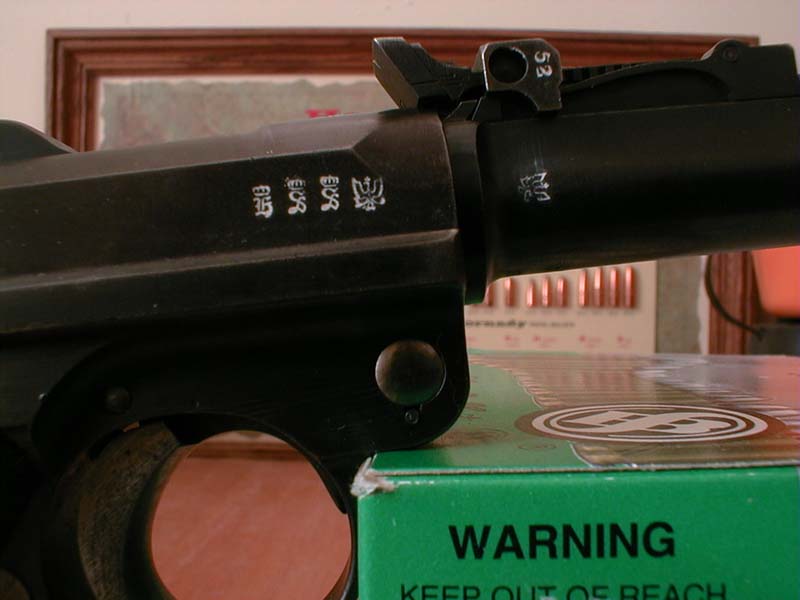

Right side of barrel extension. Note three inspection marks, firing proof, and firing
proof repeated on barrel. The fine tune index is repeated on this side of the rear
sight. |

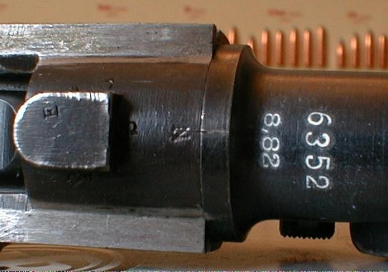

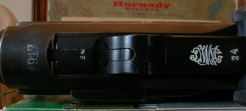

Close up of 1920 Commercial Arty Luger cannon. Like many 1920 Commercials, an attempt
has been made to remove the chamber date (1917 in this case). The attempt was not
entirely successful in this case, as the chamber date was deeply struck. Viewed from
the front, one can see that considerable material has been removed from the top of
the barrel extension leaving the barrel extension out of round. This is one of the
hallmarks of the 1920 Commercial variation. |

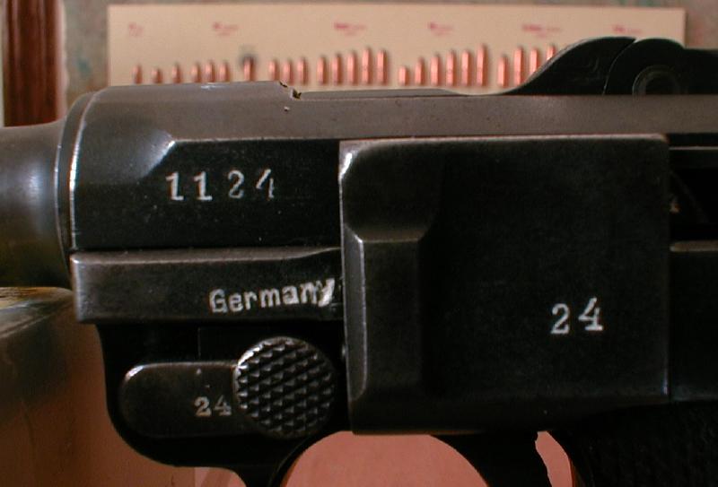

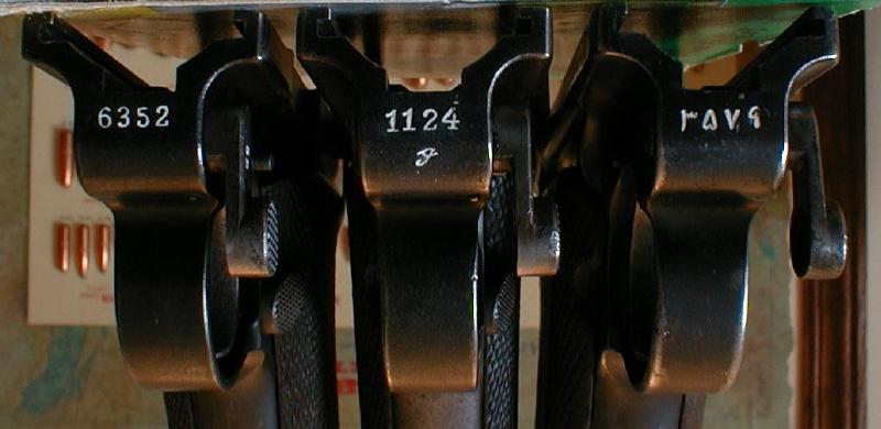

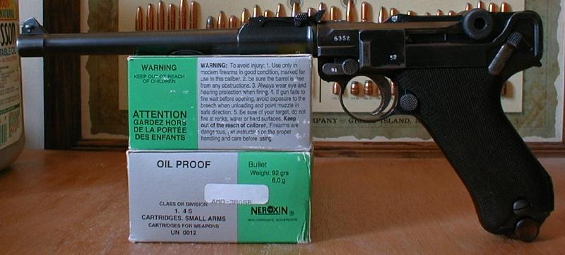

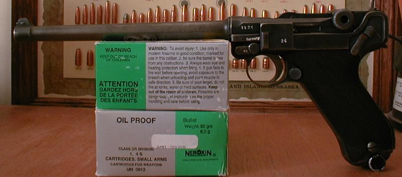

Left side of 1920 Commercial Arty. Note ìGermanyî stamp. |
Close up of left side markings of 1920 Commercial Arty. Firing proof is present,
but not high lighted and so is difficult to see. Collectors, in an effort to determine
if ìmatchingî pistols really are matching, will compare the style of
numbers - note the distinctive style of the number ì4î in the serial
numbers on barrel extension, side plate and take down latch. |

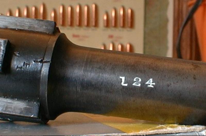

Bottom of 1920 Commercial barrel and barrel extension. 1920 Commercial barrels were
marked in a variety of ways - this barrel carries only the last three digits of the
serial number and is not otherwise marked. Note also the barrel witness mark was
over-stamped when the new eight inch, 7.65 m/m barrel was installed. |

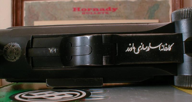

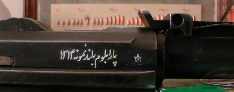

Close up of the top of the Persian Arty Luger cannon. Note the Farsi representation
of DWMís name, and the Persian crest over the chamber. |

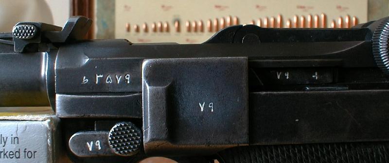

Close up of the left side of the Persian Arty Luger, showing Farsi serial number
detail. Note the four digit serial number, with a prefix. It was long thought that
only about three hundred of these were produced, but the serial number on this one
tends to indicate at least 20,000 were produced. So keep your eyes open :-) |
